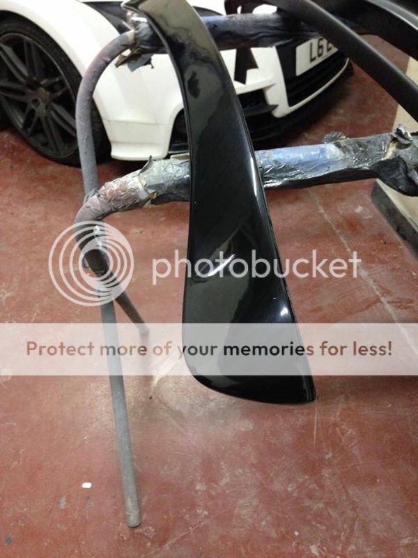

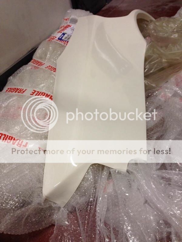

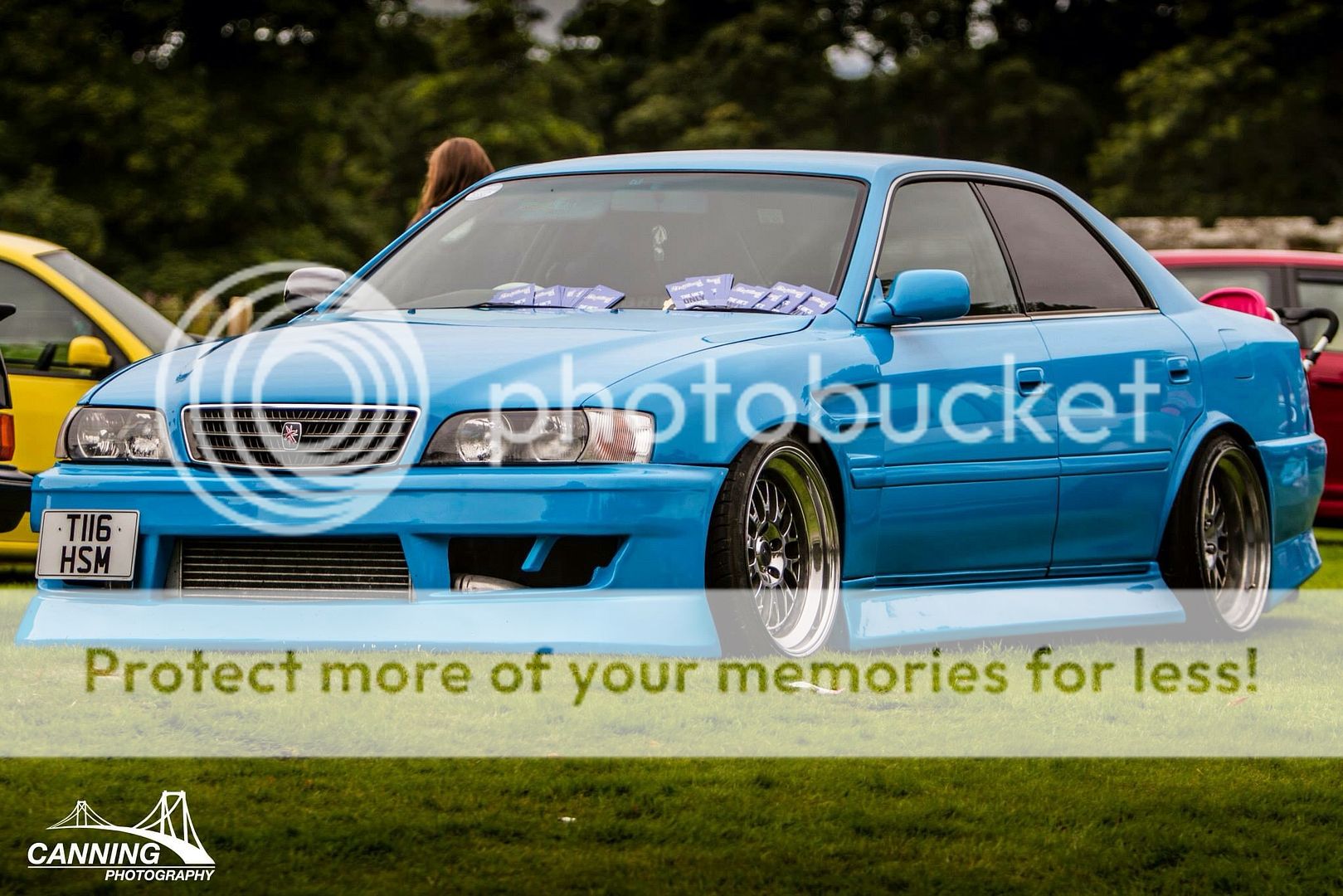

Origin labo rear window spoiler
Carbon pixels Ducktail all the way from Russia
Ganador Mirrors were found, extremely rare for the JZX100
Roll forward till in between xmas and new year

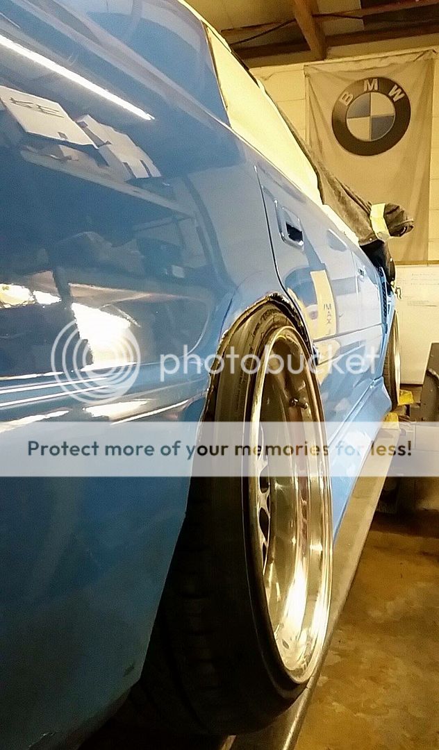

arches cut down ready for the tubs to be made. I am delighted at this height 40mm drop at the rear and we will go for another 20mm at the front.
Door panel test fitted

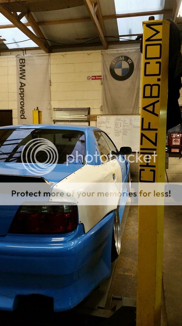

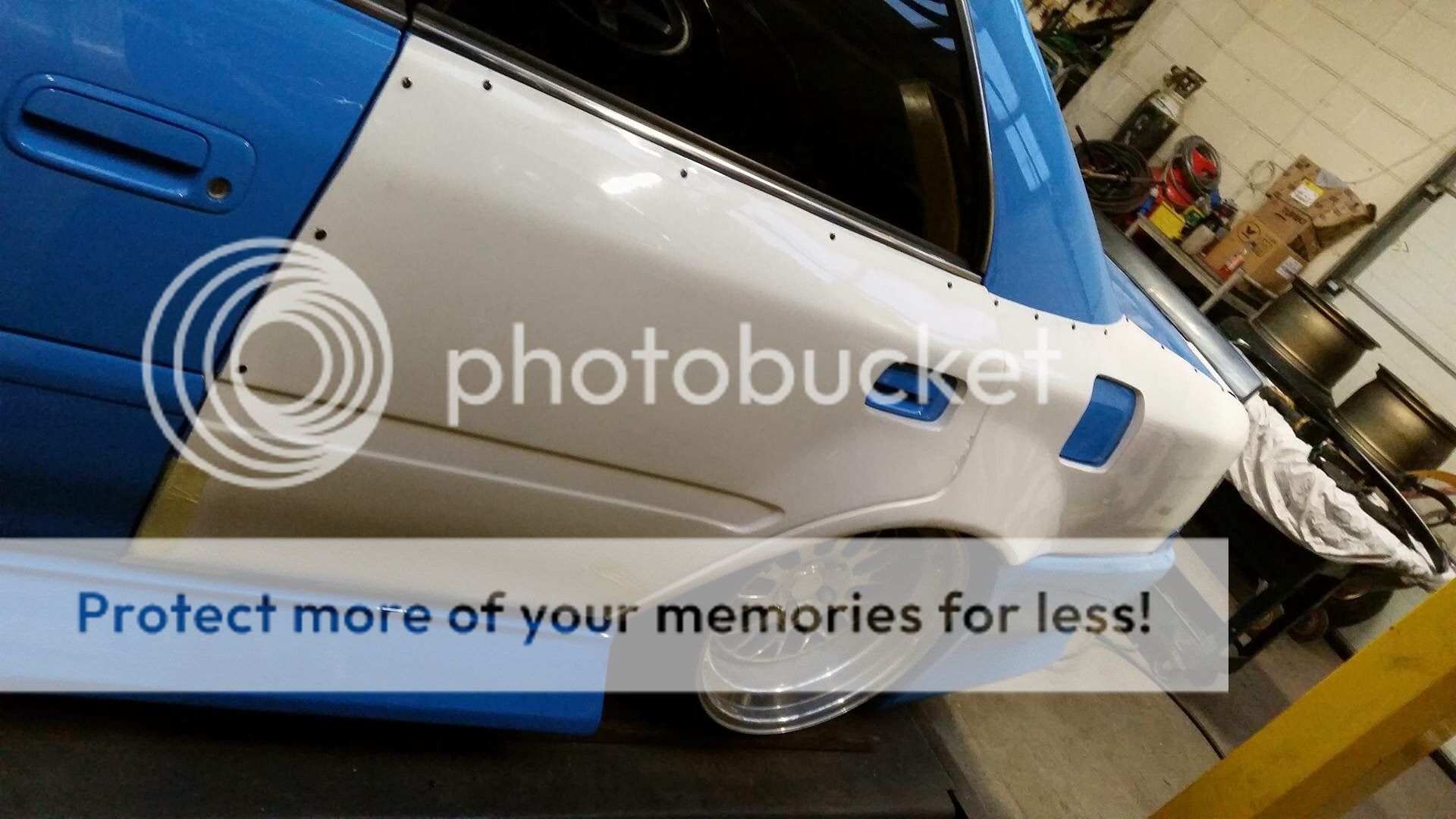

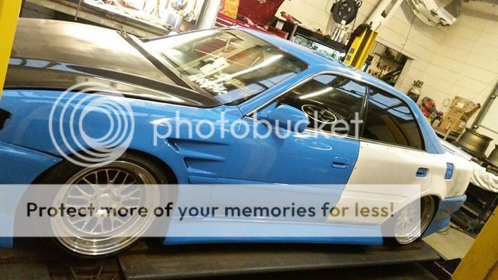

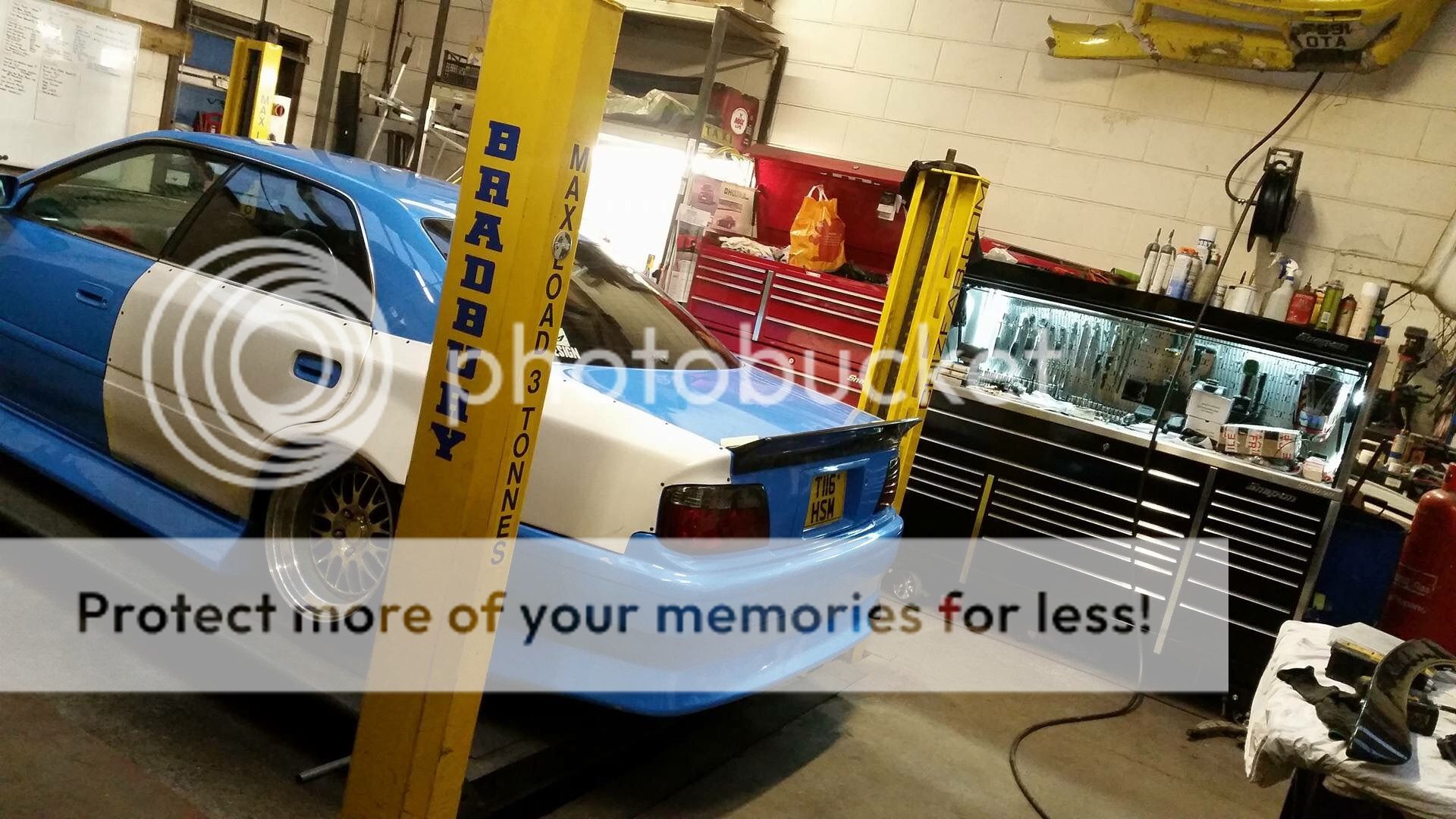

Rear fenders and door extentions fitted properly. Rear arches fully tubbed, so if a tyre explodes drifting my fibreglass in theory should not. i am delighted just to be removed as i am painting the car and fenders seperate as we have a little sneaky plan for what will be holding them back on after paint

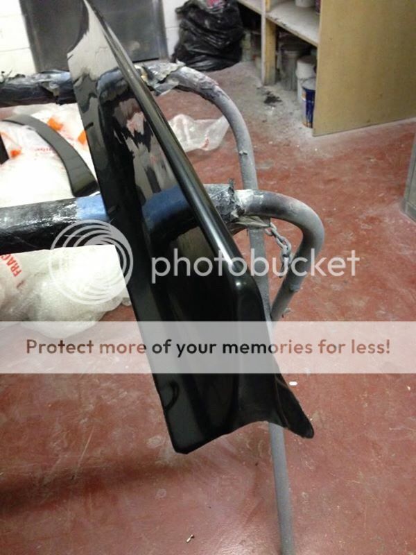

Ducktail again test fitted and think it works well with the line
Base colour for the car decided on after many conversations. So it was applied behind the fenders

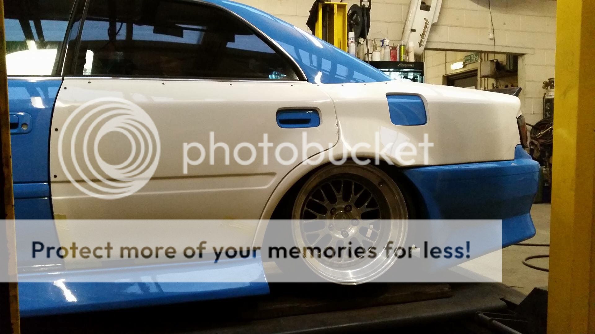

Rear fenders re attached for the final tikme and bonded and riveted on
Rear bumper to be modified and filled to look like it was always extended
New whhesl arrived

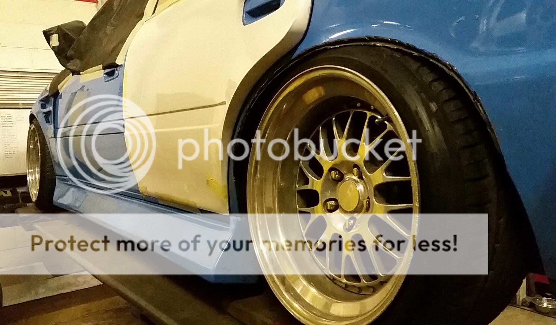

SSR sp3's in some great sizes 18x11.5 et -21 for the rears
Quick mock up of car
Yip they will work
Into my bodyshop for tear down
Rear bumper modified to fit
Fits mint now
Rest of the car stripped
Engine bay stripped as far as i can go without removing engine and some paint applied
Bay all de masked and put back together. Ignore the garden hose its getting changed out
Inner arch and wing cleaned up and painted. Coilover lets it down changed out to the new bc's as soon as its painted
Fibreglass panels given a coat of Dolphin glaze so there are no ripples once painted
Car moved out the booth so can be prepped
Ducktail cleaned up and filled where rivet indents were
Boot completed
Start of the Panels going into black high build primer
Not into fog lights and won't running them so the mounting point on bumper removed
Ready for primer
Rear bumper tow hook gap made

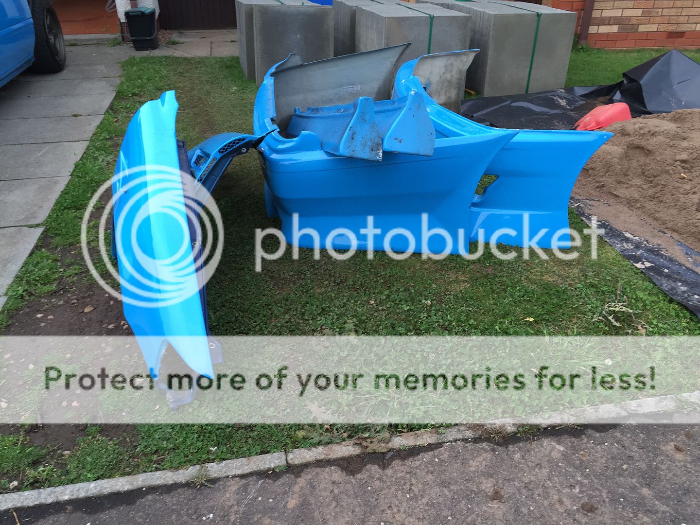

Bumpers in primer
Backs of the doors in colour
Back of the boot and bonnet painted.
Some trims painted
Nothing too exciting but finally glad to see some paint going on the car, Alot of work to get to this stage.
A cheeky wee contrast in colour pic
More bits in paint
Car into paint
and start of build up
Front end built back up
Awaiting a few exterior parts coming but mostly complete
Orange sidelights fitted
Gold Titanium Studs on the fenders
Spoilers fitted to the rear
Still got intercooler pipes to make up and change out

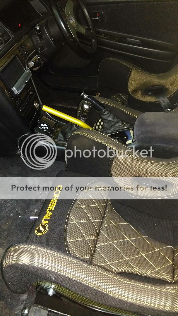

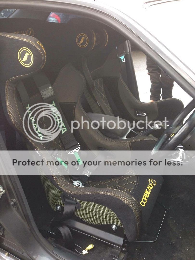

Test fit of seat. Having a few issues so new sidemounts getting made up and need to take some of the interior trim out
Front end completed
Spent the day masking up the engine bay. Some satin black and the engine cover in the car colour. TRD brace fitted
Tow hook painted and fitted
Car is back in with Chizfab now to get the rest of the little bits completed. Seats are huge so they are proving a bit of hard work
Rear solid diff bushes been done
Heyman knuckles fitted (awful pic)
Most of the braces under the car are now all put on. Amjed has been on the car a few days this week at Chizfab so hopefully hydro will be completed and seats in this week
Fitted the minty fresh cooling panel excuse the tape marks need to clean it off.
Fitted some gold bolts to the engine cover just cause had some left over from the fenders
And just some random pics.
